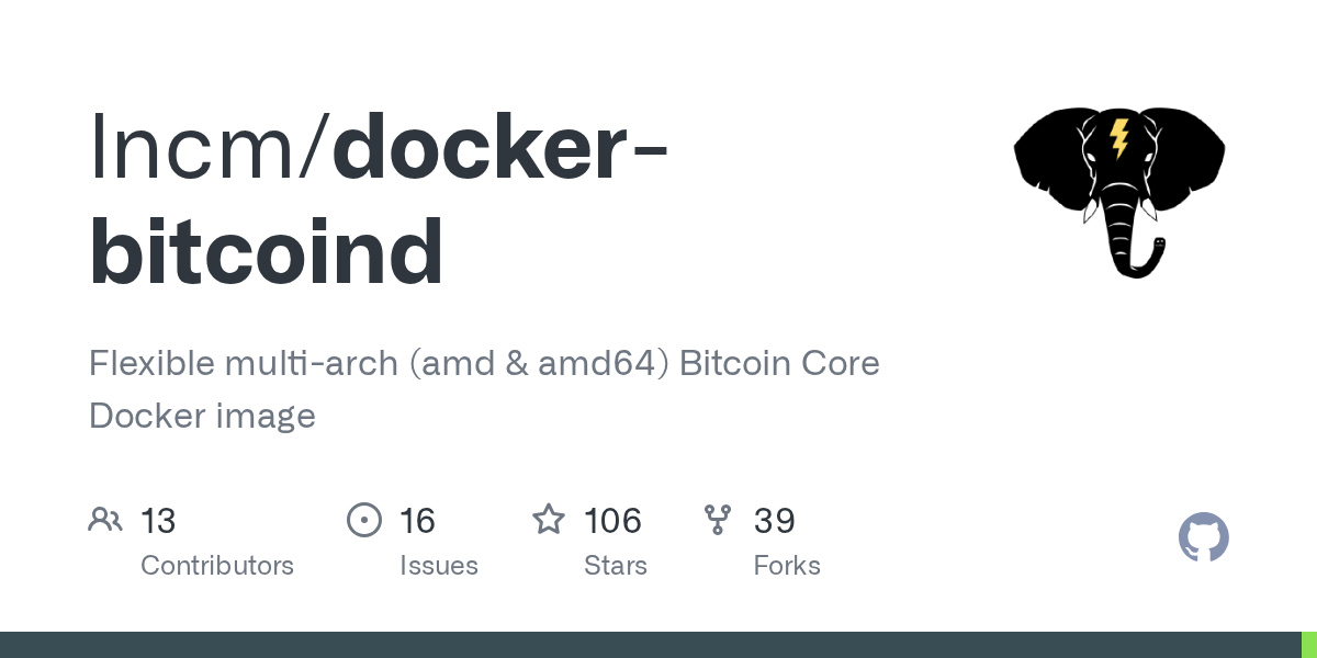

Looking at the repository (found in the information tab), they give some basic command to interact with the container itself :
Note that in Runtipi case, your container name won’t just be bitcoind but will looks more like that : bitcoind_migrated-bitcoind-1*

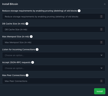

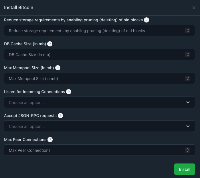

I think you should look at that:
When you install bitcoind with Runtipi you can already change a lot of parameters.
It should have everything you may want to adjust:
The first one being the prune parameter

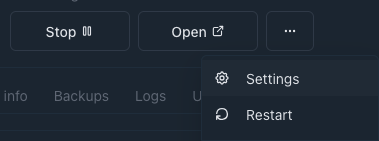

You can change these parameters at any time within app settings:
Don’t forget to restart the app after a modification
PS: This is probably all you need especially if you are not comfortable enough with docker.
I will clarify my initial explanation in another message if you want to go further later.
