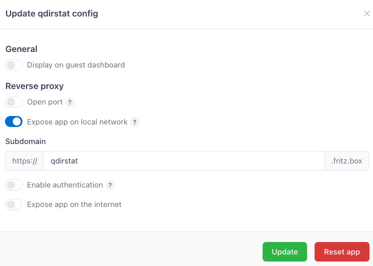

Local expose with local domain "fritz.box"
I want to open the app “qdirstat” via http(s)://qdirstat.fritz.box by exposing local.
Setup is:
fritz.box (router, 192.168.4.1) with dns & dhcp service active.
server (thinkcentre, 192.168.4.11) with runtipi.
qdirstat installed from “migrated”.
local domain in runtipi set to “fritz.box”.
This works: open application via 192.168.4.11:7125
This fails: open application via http(s)://qdirstat.fritz.box
Any hints or ideas where to look?
Thx, Tom

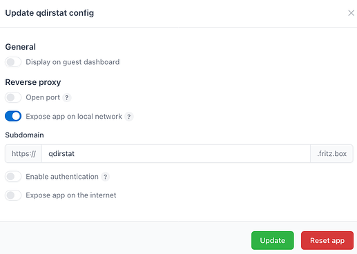

Hello @togude :wave:
We will need more precision on how it fails to access “http(s)://qdirstat.fritz.box”.
What is the displayed message on your web browser ?
Is it only happening with qdirstat ?
I tried on my side and was able to access qdirstat through local domain without issue.
The best I can do right now is to enounce how to make this work.
To access your app through local domain :
Warning
You will also need to configure your DNS to redirect all subdomains *.fritz.box or at least qdirstat.fritz.box to your runtipi instance.
This configuration will depend on your DNS server.
I believe this is where you should be lookin for.
If you have more details to share, I will try to add more precision.

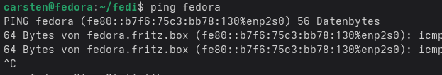

I basically have the same problem.
For example, I can find my Fedora computer under its host name in the network.
I think we have fundamentally misunderstood something.
Hello @bbtuxi :waving_hand:
The explanation and the solution are in the previous messages.
I will try to reformulate. (jump to citation for quick answer)
When you request for fedora.fritz.box, it’s up to your DNS server (your Fritzbox router) to answer which IP to reach.
In your local network, devices registers themselves through DHCP which create a DNS entry for each of them.
Why fedora is found but not qdirstat ?
The container of your app qdirstat is not in your local network, it belongs to a docker network inside your runtipi host.
Your router is not aware of your app existence and won’t create a DNS entry for it.
To solve this, refer to my previous message.
I hope this was helpful.
Let me know if you still have questions.

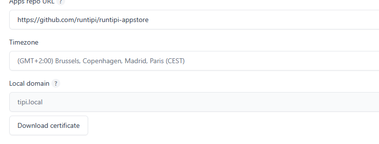

Hello,
I am trying to expose my apps on a local domain. I know I have the DNS setting correct, as I have a similar setup using caddy on a different server. In my case I use a pihole for DNS and DHCP and etc_dnsmasq_d for the wildcard record. So *.tipi.lan is pointing to my runtipi IP.
My problem is I installed my runtipi instance about 2 years ago, mostly with default settings, I have upgraded over time , currently on v4.4.0.
On my initial install local domain was set to tipi.local, the issue I am having is that I cannot change the “Local Domain” under settings from the UI (entry is greyed out), if I try modifying it in settings.json, value is overwritten when I restart runtipi.
Any pointers would be welcome.
Hello @systemocracy you have to enable “Advanced settings” to make the field editable
